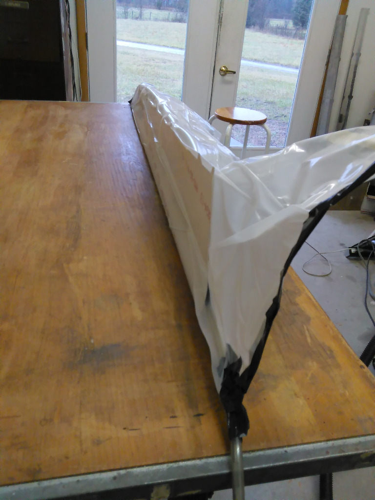

If it's any consolation, I know the feeling. My first carbon leading edge skin for one wing came out of the mold and looked perfect... except along the apex of the leading edge itself where there was significant bridging... resulting in it ending up in the bin. One of the layers in my infusion stack (possibly the peelply or the vacuum bag itself) was constained in some way and prevented the vac-bag from pressing into the apex of the curve. The same thing happened on my first attempt to infuse the tail fin leading edge, despite my earlier experience and best efforts. Expensive!!
Following those two screw-ups I modified the way I assembled the infusion stack and achieved perfection

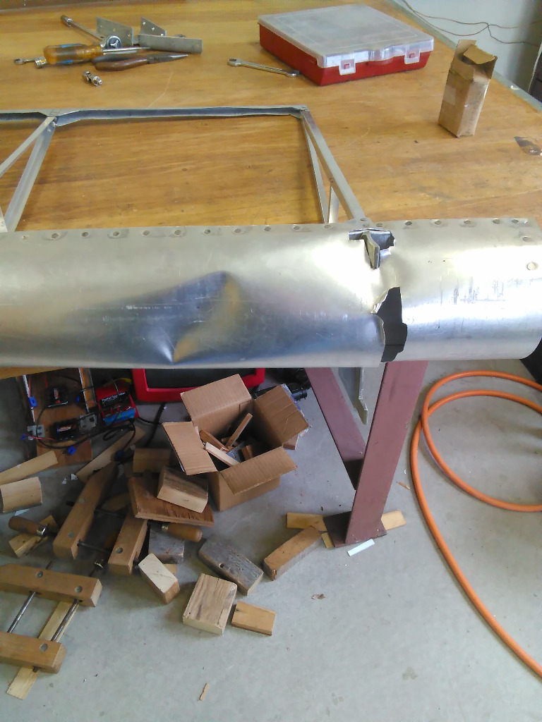

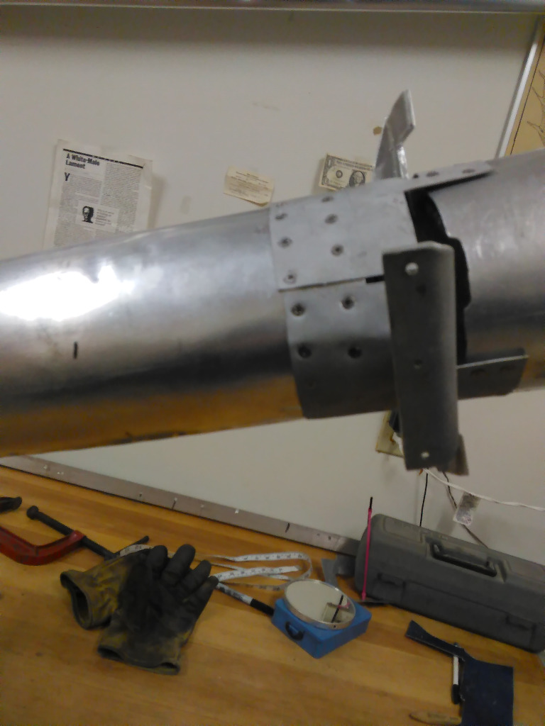

I see the spar cap under compression buckled and failed between two ribs, as might be expected. How did you stiffen your spar (caps/web) when you repaired the damage?
Stiffness can be dramatically improved by adding 'thickness' to a part without adding significant weight. In my case, all my spars are fabricated using just two layers of 195gsm twill cloth (cut at +/-45deg) and are very light and bendy. They are stiffened by the fore and aft ribs bonded to the shear web and between each pair of ribs by a strip of light weight foam board (25mm wide x 5mm thick) are laminated between the two layers of cloth. This significantly stiffens the shear web without adding much weight. The spar caps are stiffened both by the carbon rods that are encapsulated between the two layers of cloth and further by the leading edge, where it is bonded to the spar caps, lending horizontal and torsional stiffness.
