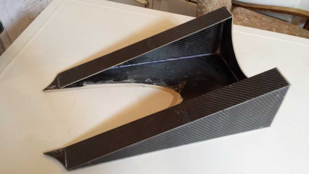

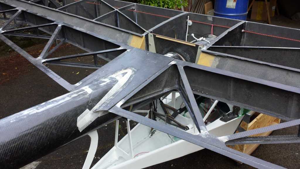

Progress on Phil Lardner's All-carbon CD? (Part 1) 17 May 2016 19:07 #968
A few more photos of what I've been up to recently...
The Turtle Deck - between the flaperons:

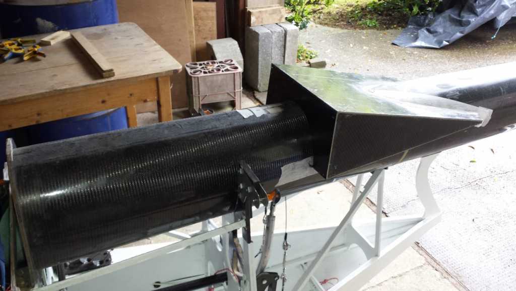

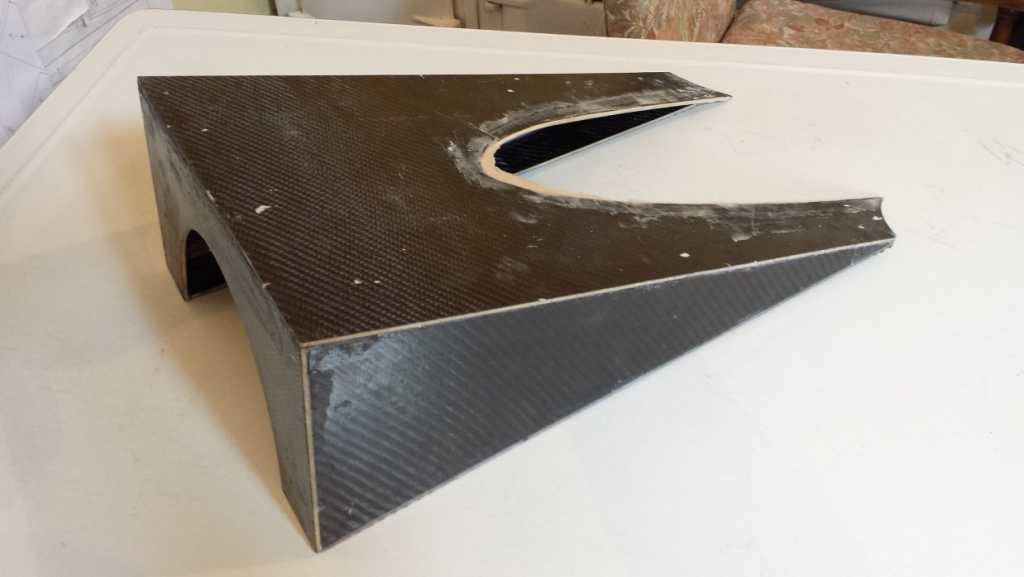

Progress on Phil Lardner's All-carbon CD? (Part 1) 17 May 2016 19:19 #969
The Turtle Deck:
