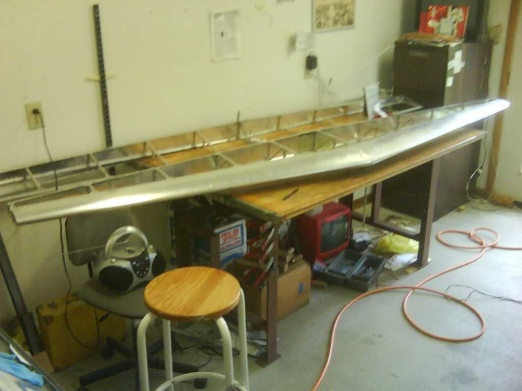

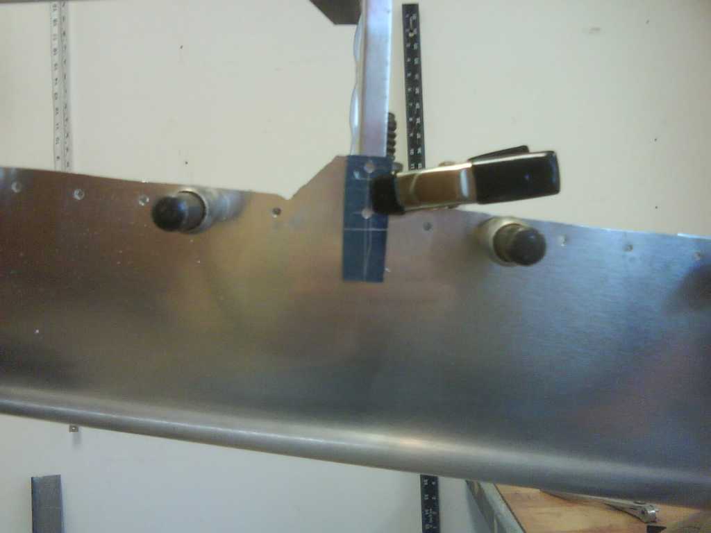

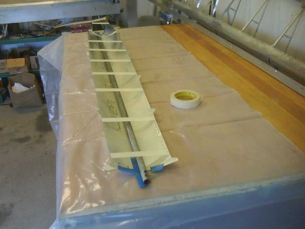

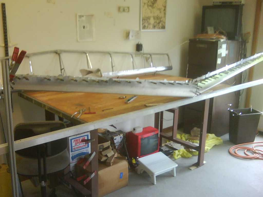

working on horizontal stabilizer...I formed the leading edge using the vacuum method, works well. shown here is 1/2 LE.

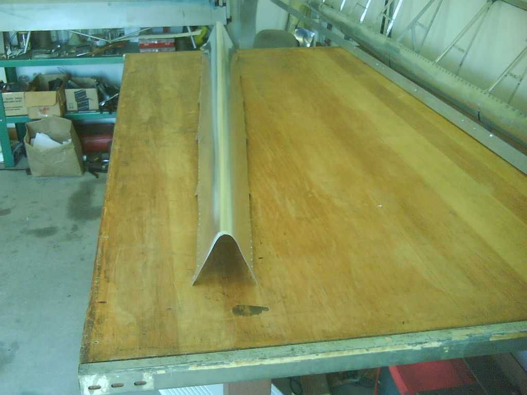

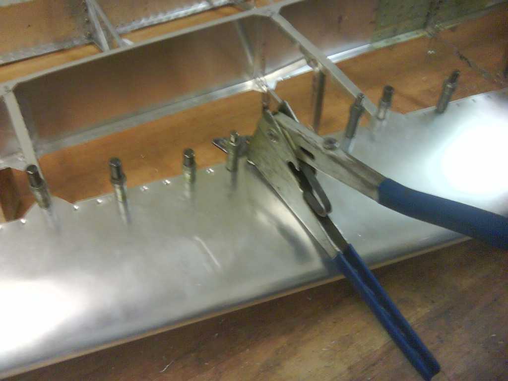

Leading edge 2 halves horizontal stabilizer being spliced.

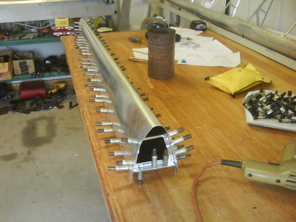

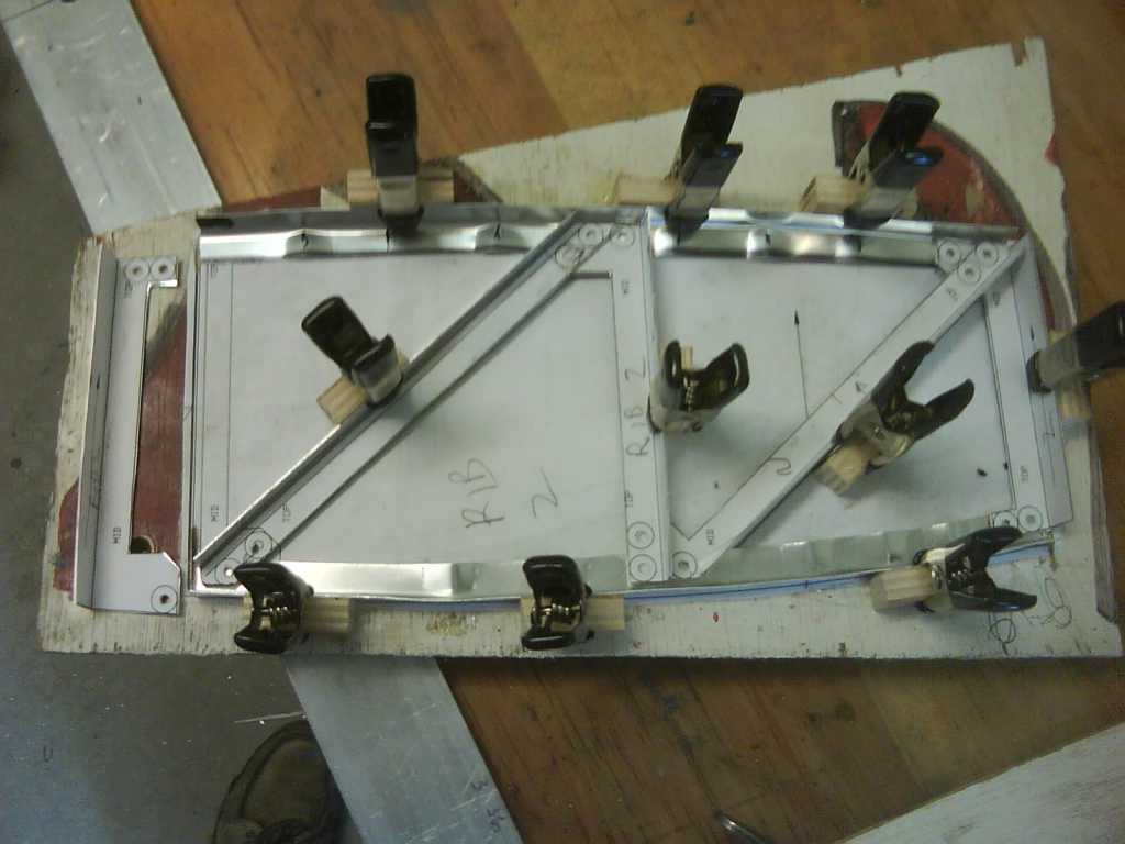

Improved rib assembly fixture.

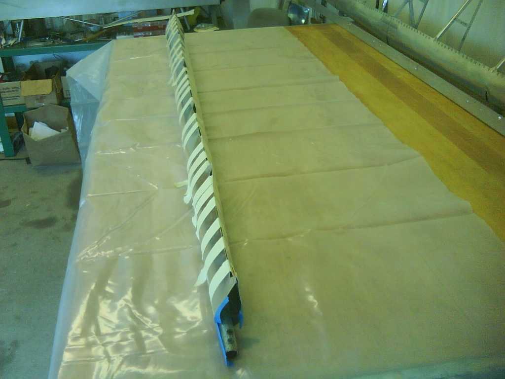

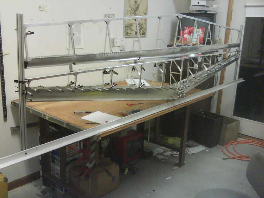

Horizontal stabilizer and elevator. Final finish of the ribs not drilled until line up at this step. That's why all the clamps

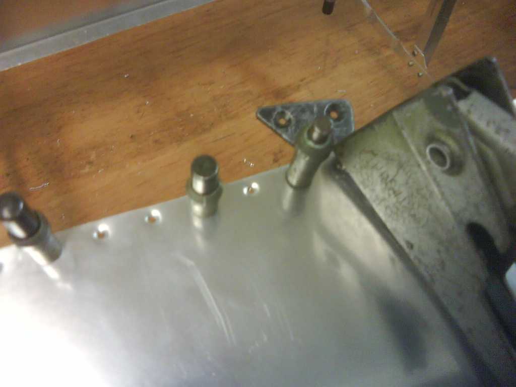

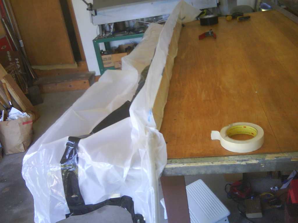

Drill Guide, dimple with pop rivet tool

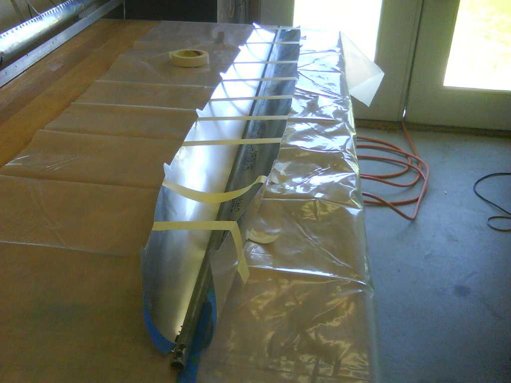

Horizontal Stabilizer done except for fabric. Weight of 4.7 lb. which when added to the weight of the elevator of 3.4 lb = 8.1 lb. The original wood horizontal tail weighed 8 lb. Stay tuned for the load test to limit of 12 #/sq ft.
