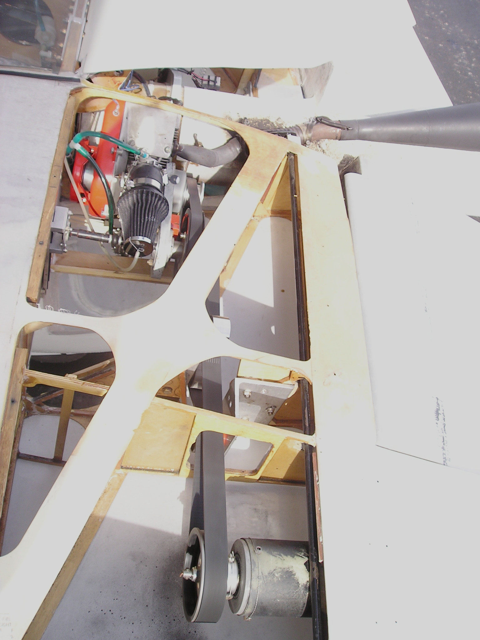

The Alnair here is my powered version of the CD shown [see Photos tab] landing on her first hop as N601CE 02/17/2004. I experienced a climb that day of 500' p/min on the 10 hp single cylinder 2-stroke embedded in the port wing root and belt reduced out to the 64" folder. Unfortunately the ship pod was destroyed in a trailer haul mishap in 2007. I am nearing first flight of a new two place side by side under the same wing. Wing has been tested to 5.41 g+ with single but I will definitely test again for new loads before attempting flight of the new two I call 'REALM'.

Phil Lardner writes: Looking at your Alnair photos, I see one that shows the pilot pod with a small diameter propeller sticking out the back, below the tail boom. I'm guessing this was an early incarnation and probably didn't generate enough thrust (and hence the larger, off-axis prop)? All the best, Phil.
Gus replies: Right U are! Too small 5 hp. Zenoah engine and prop... but went to the 11 HP engine; seen in the off axis photos, in that same stinger position with a 28 inch prop and a Shindaiwa EB254 leaf blower mounted in the main wheel fairing (you can see the hole where it sat) to cool the thing adequately... worked well but still was only essentially a modest sustainer though it would allow anemic self launch.
