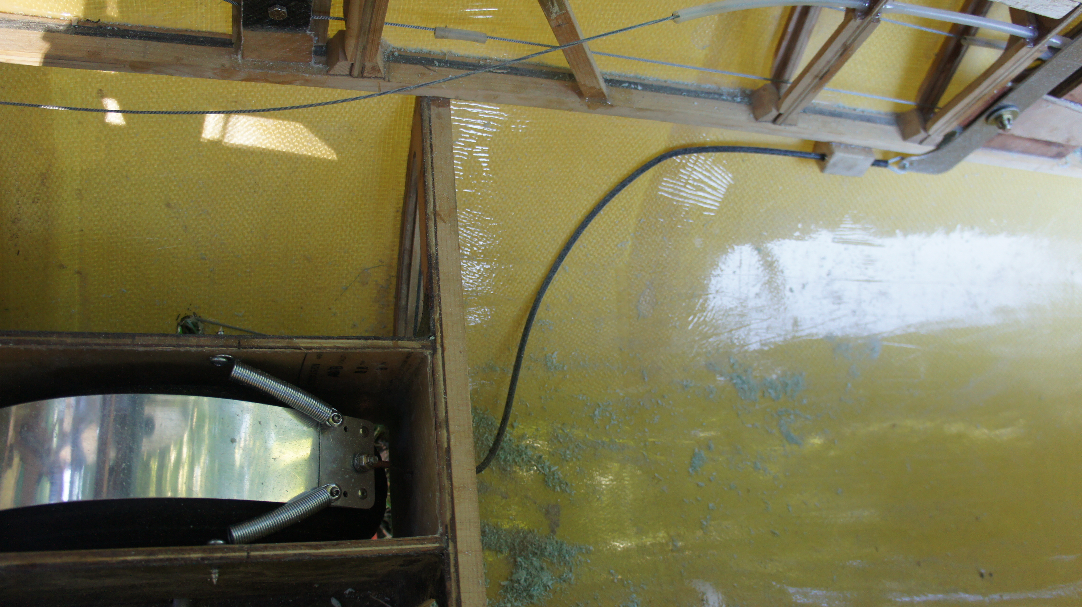

Rick has added spoilers to his wings. You can see them as he passes the camera on finals. These replace the single delta-shaped spoiler behind the pilot's head which was of limited use.
"Mick at Wallaby Ranch said he mounted his spoilers on the spar line and worked fine. So I mounted mine in the same place and did a lot of work to make them flush and made an over center actuator to make them easy to operate. When I used them though the nose pitched down so much I could't level the glider. They are definitely mounted too far forward. Now I have a lot of work to do to remount them." - See the 'Notes' tab for an update and fix to this problem.

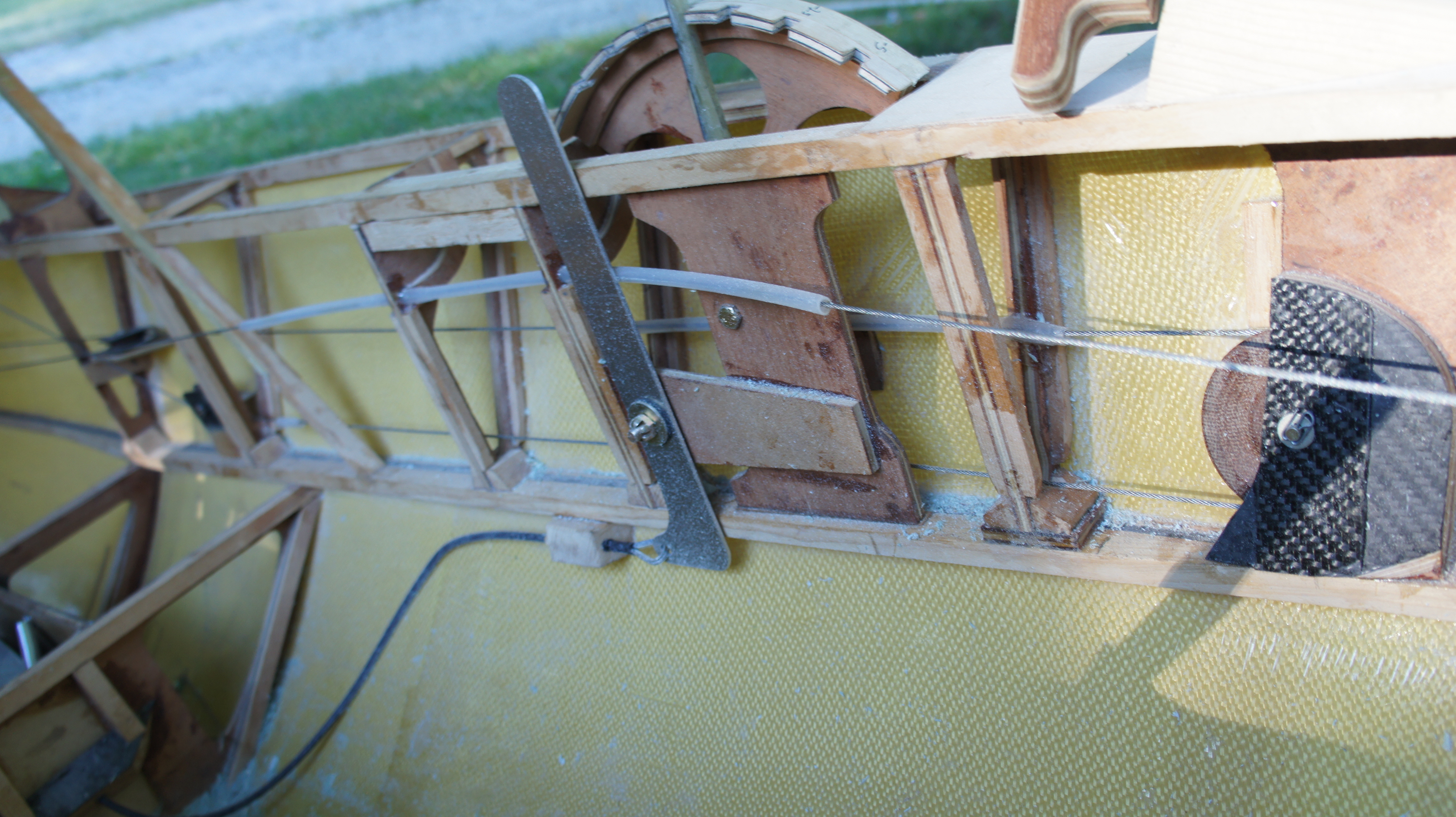

A view of the spoiler actuator mechanism inside Rick's wing.

[Rick] Re: wing-mounted spoilers: Mick at Wallaby Ranch said he mounted his spoilers on the spar line and worked fine. So I mounted mine in the same place and did a lot of work to make them flush and made an over center actuator to make them easy to operate. When I used them though the nose pitched down so much I could't level the glider. They are definitely mounted too far forward. Now I have a lot of work to do to remount them. [Update: Jun 2015 - Rick discovered why he was not able to correct the pitch-down problem even with the stick fully back. It turnd out that he did not give his elevator enough +/- travel when constructing it. The original plans call for the elevator to be able to move +/-30°. This is an easy problem to retro-fix, and Rick now has plenty of elevator control to counter the pitch-down he experiences with the air brakes fully deployed.]
