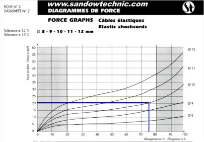

We used 10mm diameter bungee rope from Sandowtechnic.com, which yields around 22daN / 22Kg of force when stretched 75% beyond its unstretched length. I would be reluctant to use anything thicker than 10mm as this is on the limit of what a single person can safely stretch on their own - and even then, one slip and you can launch yourself 'over the back!' :-)
