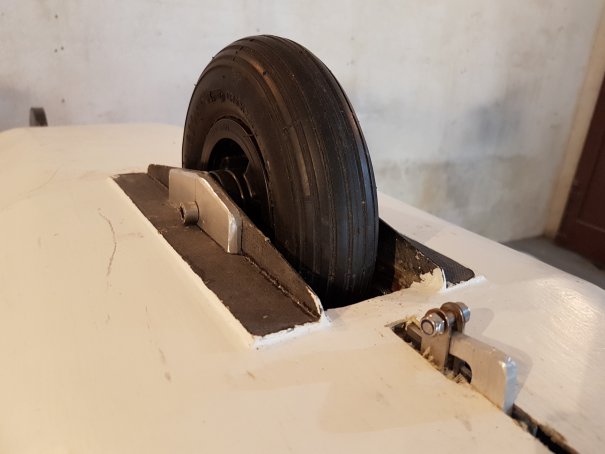

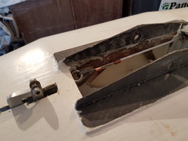

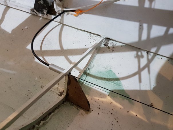

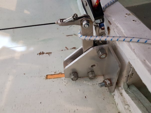

I couldn't agree more! The problem is that we only have one glider port here and their grass strip is too short to get any decent height on a car tow - it also undulates horribly and has to be cleared of sheep before use! There are a small number of private strips (for microlights) and all are shorter than I'd like (~400 - 450m). My one hope is that Kilkenny aerodrome (1100m) will let me use their grass strip early in the morning before it gets busy with their sky diving operation. Watch this space...
PS - not sure if I mentioned it earlier, but the new aft release works really well - super easy to release under full bungee strain.
